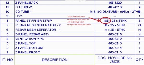

I would like to add component level parameter of blank size into BOM table generated by repeat region. I tried relation in repeat region to provide the condition to add parameter for particular compnent, and for other components I need drawing number in the same column.
I am not able to see the component level parameters in repeat region relation window. Refer attached image in this for row no. 8 i want to call size 485 from component level paramter. This is sheet metal part having the parameter for overall size. Pls help.

Yeh its there but i think this will be applied to entire column and not to the particular cell. I want to add particluar component parameter like 'Length of component' in only one cell of column whereas in other cell of the same column i want to use different parameter like 'drawing number'.

Repeat regions are based on repeating the same set of instructions for each row in the region. To make a change like this you need to create a repeat region relation that examines each part to see if it has the information you want and uses it the way you want and creates a region parameter that will be displayed in a column in the table.
A possible solution is to have a repeat region relation like:
IF EXISTS("BLANK_SIZE")
COLUMN_ENTRY = BLANK_SIZE
ELSE
COLUMN_ENTRY = whatever parameter is used now
ENDIF
Then the repeat region uses rpt.rel.blank_size to set the values for that column.
