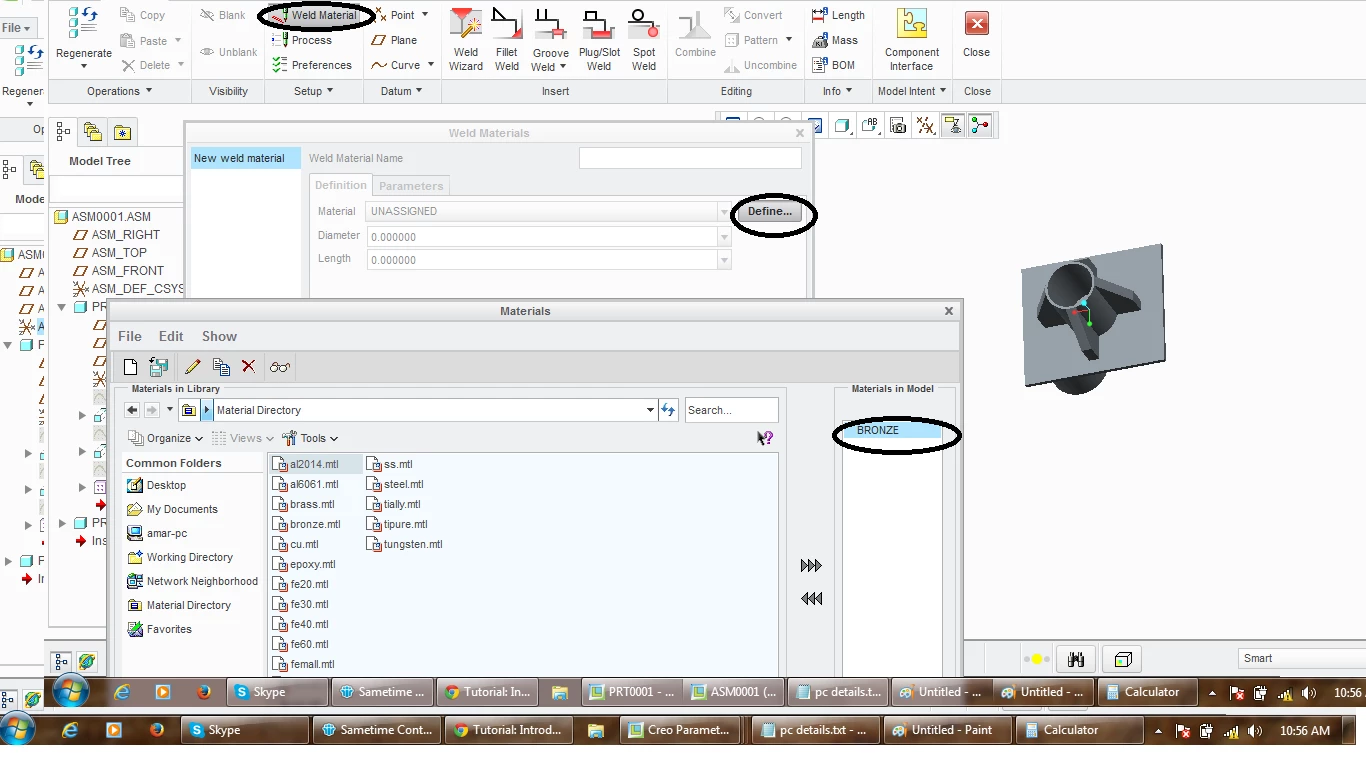

I have treid to assign weld material but it is not taking
Please find the image.
April 7, 2014
Click on the text new weld material in the left section. It woyuld add one material WELDMAT001. Then you can defne the material.
