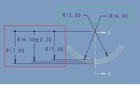

I want Dimensions type as marked in green color, but when I'm retriving dimensions from model I'm getting like as marked in red color. I'm tried with dimension code placing in driven dimension also.
Thanks and Regards,
Naveen Kumar Gongu

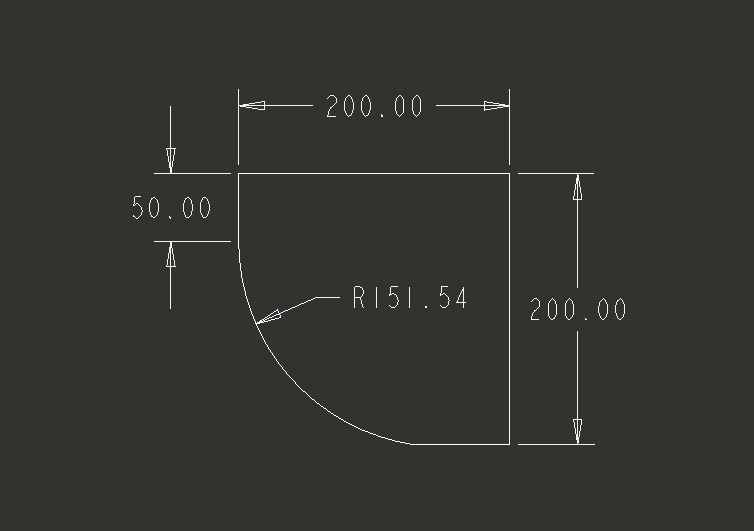

I do not having that problem, I have tried with one sample model, attaching for your reference. the dimensions are retrieved from model dimensions.Untitled.jpg
It would be better if you can upload your file,
