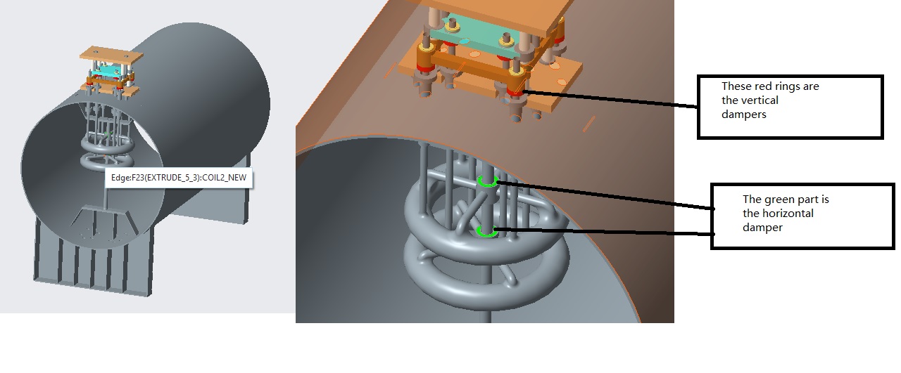

     I attached a picture of my model. Its a support and motion system for those two magnetic sheath coils as you can see from the picture. There is an impact force for 70 t vertically and 20 t horizontally and plus the torques. Everything is set in place. Materials, forces/torques, constraintes, interafaces.etc. As for the materials there are vertical and horizontal dampers in the model. They have a  different material with a different Young's Modulus and poissons ration( as it should be). I have used NBR(I think thats what its called) rubber. With the help of your online resources and others help Im glad I can now do static analysis. Modal Analysis and even dynamic time analysis(I have the needed input function for the structure). Im familiar with all the steps and all.But wanna learn more actually I need to learn more, thats why I love doing this , you always get to learn more.
     Okay. Everything in place. My question is. How to or Is it possible to calculate the damped forces and also the stiffnnes of the material Im using for damping. Thing is I need the damped forces to do the static analysis so that the structure of the system stays in limits as needed. Stiffness I just want to know out of curiosity. I mean its not a fault to learn more right?..

PS: This thing is huge like the cylinder is 10m longer. You can imagine the rest with respect to the cylinder.
