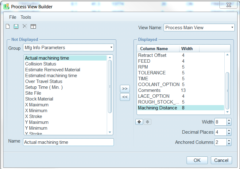

We need to calculate Tool Travel length for planning Tool Change and maintaining tolerance. Any support on this is appricated.
Product : Creo Production Machining.
Best answer by NickMihelich
in your process manager you can display Michining distance. I think this is what your looking for.Capture.PNG
