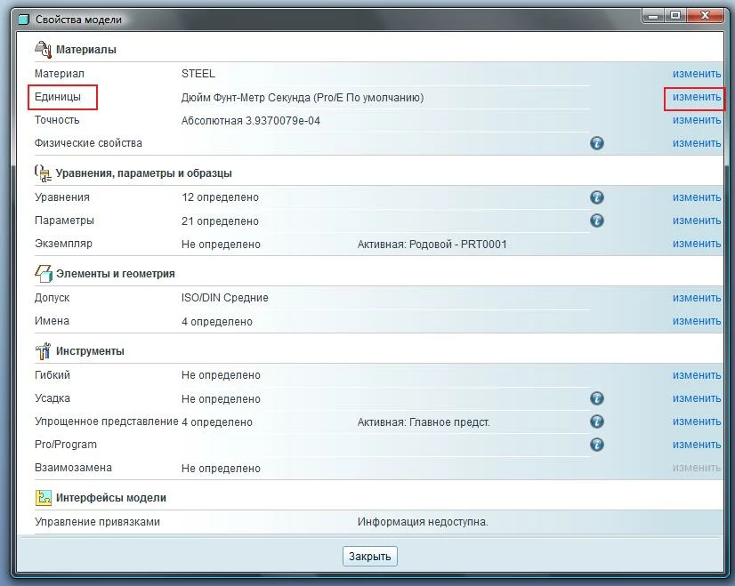

I have made parts in metric instead of imperial measurements. can anybody tell me how to convert them? I am currently using WF5!
    October 27, 2011
    Hello!

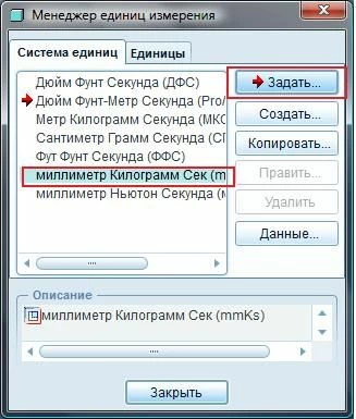

    You need to go in WF5 in a tab "File" -> "Properties" -> "Units" (select on the right side "Change"), further to select necessary system of units and then select "Set".
