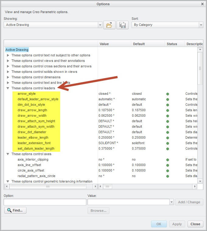

How to change the arrow size in Creo 3.0?? and also the tail length of an arrow?

Is there anyway to set the specific arrow size and length for the whole drawing rather than selecting every arrow and changing its dimensions??

Hi Syed,
In the drawing, go to File > Prepare > Drawing Properties > Detail Options > change and try changing the following to see if that helps:

Thanks a lot Amit. It works to change the size and length of the arrow head. But still i couldn't able to change the tail length of the arrow. Is there any option or tool to make the tail length shorter?? I have attached a screenshot below for reference.

Witness_line_delta
