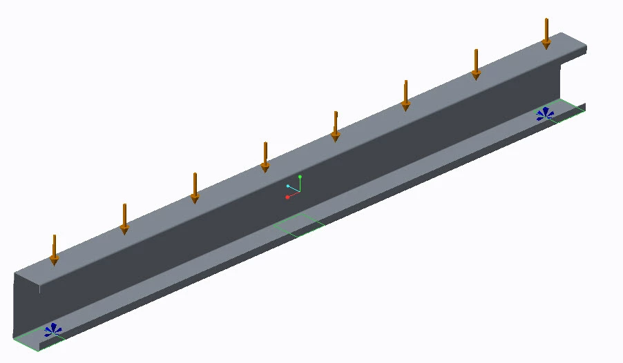

What is the best practise to create constraints for a profile? The thickness is 1-3mm and length 1000 to 6000. I am using family table and want to make sensitivity study.
I am using shell pairs and I create surface regions as constraints. This causes singularities to the edge of the regions and
the result stress von Mises is unreal.

There are different techniques.
1. Extend your model to also include what the profile is attached to. This might involve contacts (which need to be modeled with solid elements in Creo). Whatever it is your profile is attached to, this is elastic and can deform, which reduces stress peaks at the edge of your constrained surfaces.
2. Ignore the stress peaks at the edge of your constrained surfaces. The critical stress can be evaluated using for example the hot spot method, which extrapolates the stress from the "interior" to the edge where your non-linear stress peak is located. For example the IIW has documentation on how to use the "Hot spot method"
3. Use a beam combined with a weighted link, that connects a beam endpoint to your constrained surface. The weighted link allows some deformation of the target surface and you will get more smooth results.
In eihter case, you can still use for example the hotspot method to evaluate the stress level. This is OK according to some norms, I think also the Eurocode 3 standard allows evaluating welds according to the "hotspot method".

Thank you for the answer. I made as in your first answer. Now it looks better. I made an assembly, I will attach picture later. I need to test rigid links as well.
I can not ignore peaks, because I need Excel graphs for different height and length  of the profiles. I am going to make sensitivity study
and profile lenght is varying from 1000 to 6000mm. And even 12 000mm profile lengths.
Beam is one what I need to consider.
I noticed one rather strange thing. When I change the profile length from 1000-5999mm, I can use shell for meshing. But when the length is 6000 or more, Creo  automatically use solid surfaces for meshing???

How about just using beam elements for your sensitivity study?
  • you can export graphs directly to MS Excel
  • Much faster to run
  • Usually enough information for "standard beam bending"
The beam length is not something that drives element types. Please check your shell definition with review model.
