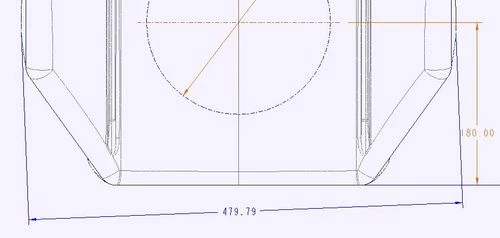

I am trying to create a horizontal dimension to the silhouette curves af a part.  In 2.0 I would get prompted for dimension orientation.
Is there a trick to create the needed dimension in 4.0?

In Creo 4.0, Orientation will change per cursor placement. Try creating dimension and move cursor to get correct orientation.

I have tried that without success.  No mater where I move the curser, the dimension remains the same.  After placement, if I select the dimension, the orientation button in the ribbon is greyed out.
It is acting as though one of the silhouette curves is being treated as a straight line.  I have tried selecting on different areas of the curves with the same result.

when creating, just before you place it, right click and you have options to set it perp or par to an entity. Try that.
