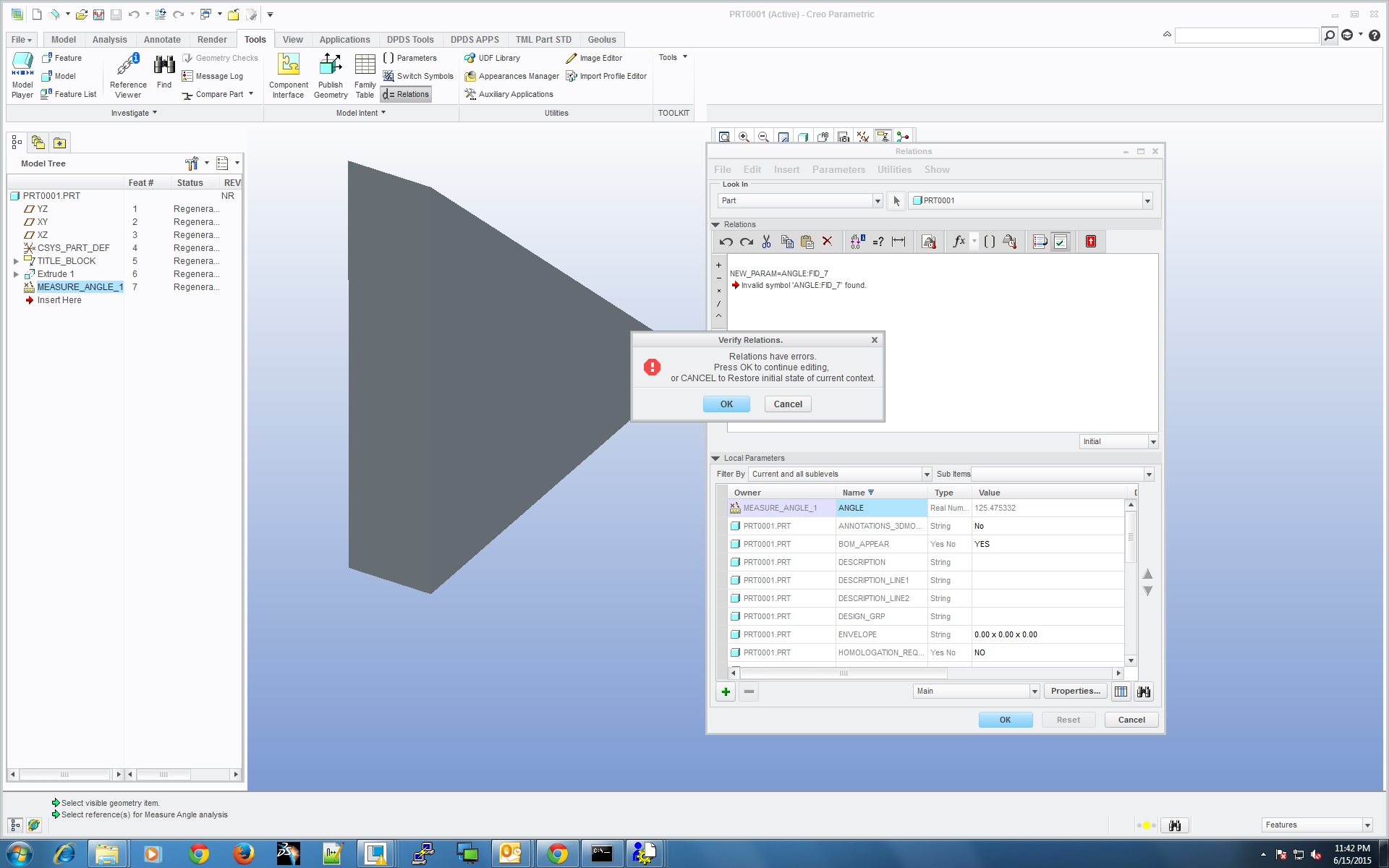

Hi..
I have created feature to measure dimension from analysis, now i got the feature parameter but i want to convert it to model parameter.
so please can anybody suggest how to do it ?

Thanks Mahesh for your reply,
But still I am unable to add relation, I got relation error.
please can you suggest.
Prashant

I think you are using feature number instead of feature ID, replace 7 by ID. It should work.
