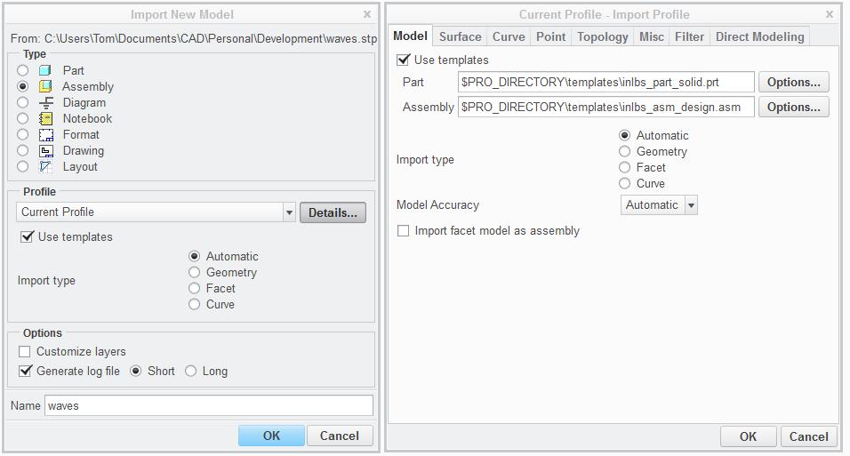

What you are saying is that model imported incorrectly and the part is now very small and you need to enlarge it by 25.4x. If this is not correct, please clarify.
Unfortunately, if this is the case, it is the part files that are the wrong scale, not the assembly. Each part has a units parameter that must be corrected. Changing the units in the assembly will not affect the parts used in the assembly.
Not knowing yet what version you are using makes htis difficult but I just found something in Creo 2.0 that seems like something you need to know about.
Here is an image of "opening" (importing) a step file. I checked the option to use templates and clicked "Detail..." to get the second window. Here you can select the default template you want to use for the assembly -and- the part files. This has been a lifesaver for many of my imports.
If this simply is not an option, you will need to go to each part and do the following:
FILE/PREPARE/MODEL PROPERTIES/UNITS -change-
In the dialog click "millimeter Newton Seconds" and click "Set..."
In the new dialog you have options of how to scale the part
You want the default "Convert Dimensions".

That is the problem I am trying to understand, Raj. Creo does not care if the part is inch or millimeters at the next level assembly. If the part is properly defined at the units it says they are, then the assembly will make the metric/inch conversion correctly without issue. In your case, the imported files are not imported correctly.
If you do not have the option to properly use the template files for importing, I do not know of a simpler way than converting each part individually. There should be ways to automate this but I do not know how. Otherwise, you might be able to make a change in the source files to correct the units there.
