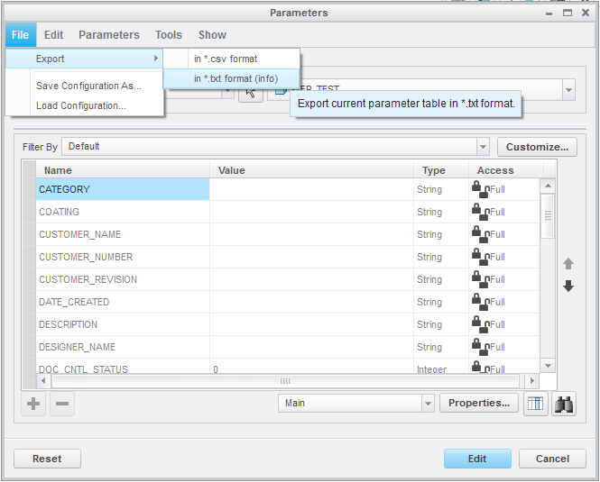

In order to save time I wanted to copy parameters from one model into different models that have incorrect parameters. Maybe someone had the same problem and could somehow solve it.
I would appreciate any quick response!
Thanks.
Michael
December 3, 2015
When you say "incorrect parameters", do you mean the parameter names themselves are wrong or the values are wrong?
You could always export the "good" parameters to a text file:
One you have them out, edit the file so they look something like this:
PARAMETER1 = "ABCDEF"
PARAMETER 2 = 123.25
PARAMETER3 = YES
Then you can copy this text into the relations section of the other parts.  Verify the relations, then simply delete the relations.  This process will create the new parameters and/or copy the values to the existing parameters.

test solution published by Doug Schaefer in Copy Parameters Between Models
MH
December 4, 2015
That post is 6 years old (never mind the system generated date), but I have tried it since in Creo 2 and it still works.
