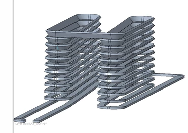

How to correctly sweep through this curve?
Made this curve through points, it supposed to be a conveyor belt
When i tried to make a simple sweep, drew a rectangle at the starting point, it swept it along the trajectory by rotating the rectangle, based on the curve's direction. So the rectanlge didn't remain normal , and I couldn't figure out which setting to use
So the question, how can I make this sweep, so the rectangles sides stay normal to something, and doesnt rotate?
Or is there an alternative way to do this? I just want a rectangle section along the curve
Here's the file : files.fm/u/dpqvzrxw#
Thanks!!

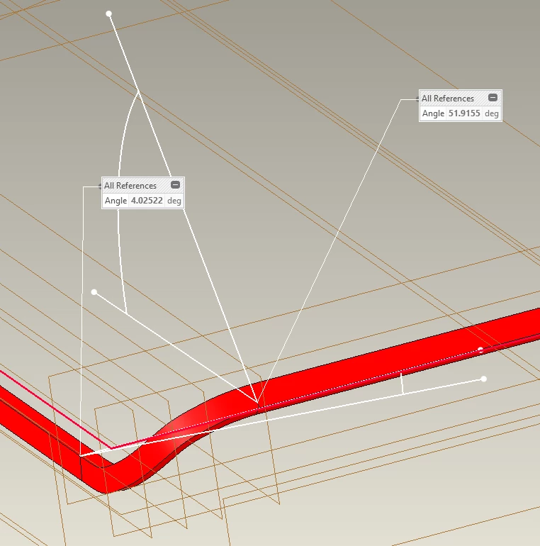

Dec 23, 2024 8:36 AM UTC
Hi, did you find any solution to this problem?
I know it's been 7 years, but I have a similar problem with control of my sweep and preventing an unexpected twist.

Dec 23, 2024 10:15 AM UTC
Set "Section plane control" to "Normal To Projection" in sweep References.
And set datum plane witch will define orientation for sweep section.

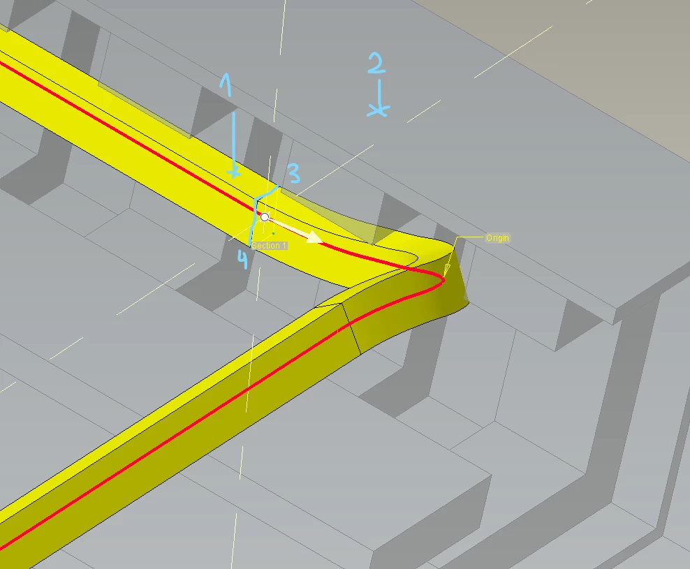

Dec 23, 2024 12:47 PM UTC
@Van_AG thank you , but can you please be more specific? I have about 25 planes in this design, I know you don't see them.
That rectangle must be rotated 90 deg, so the angle that now has 51.9155 deg should have 90 deg and the other one should have 0 deg.
I'm not sure which datum plane to pick as it doesn't generate anything when I do. It doesn't allow me to sketch the profile anything when I do.
Which planes to pick?Which planes to pick?
1 must be parallel to 2 and right angle between 3 & 4. The turn to bottom left must be flat as well, with the bigger surface on the top.
