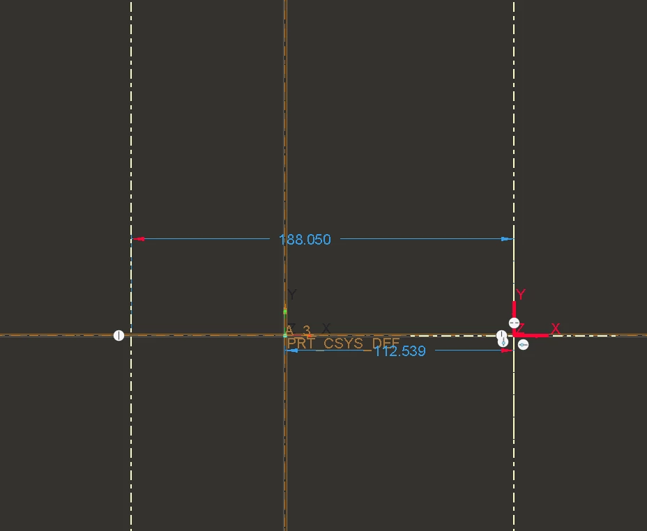

In a sketch, I draw a first datum centerline. Then I want to draw another centerline at a certain distance from the first centerline. My problem is that when creating the second centerline, CREO seems to select the nearest geometry edge to specify a distance. How to specify the first centerline as the reference for the second centerline ?

One option to do this all within the sketch is to drop a sketcher coordinate system in the sketch before creating the centerlines. Create the first centerline coincident with this csys and then add the second centerline.

Thanks a lot tbraxton, this helps definitely in my case. However, it is strange that there is no feature that would take any existing centerline as a reference for subsequent centerlines ?

It is an issue with how Creo uses references for the intent manager to create dimensions in the sketch. I am not aware of a way to select a sketched centerline as a sketch reference within the sketcher. This type of scenario is addressed through the use of sketcher constraints and sketcher construction entities.
