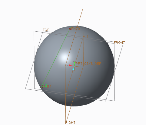

Hi All,
I have a sphere and an axis passing through that sphere. I want to create a datum plane such that it is normal to this axis and tangent to the sphere. Creo 3.0 won't allow me to select the axis and the surface at the same time. Am I missing something?

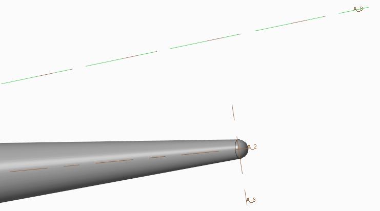

I actually have a part of the sphere which is less than a hemisphere. So mathematically there should be only one plane which is tangential.
I want a plane normal to A_8 and tangential to the spherical tip.
I was hopping to avoid creating a point on the surface as it would mean a lot of geometrical calculations.

I know this isn't the "Magical" answer your looking for,  but I don't know how your gonna get where you want to go without additional construction geometry.
In this case,  I would Sketch a curve...   Normal to A_8 and Tangent to your dome...
Then create your plane Through the sketch curve,  and Normal to A_8.
Good Luck
Bernie
