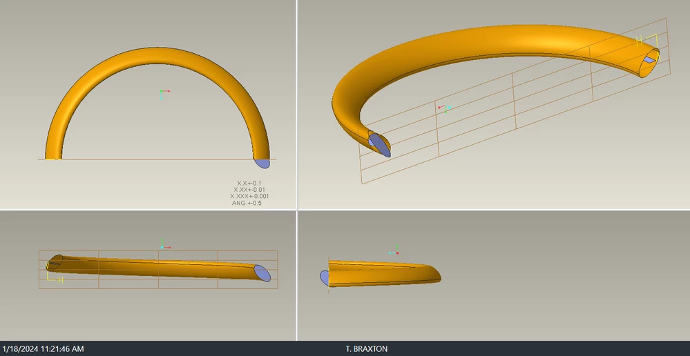

There is a circular face and I want to create a helical sweep (like a spring) from it. However, the origin circular face is angled such that it is not normal to the helical trajectory.  Currently using Creo Parametric version 8.

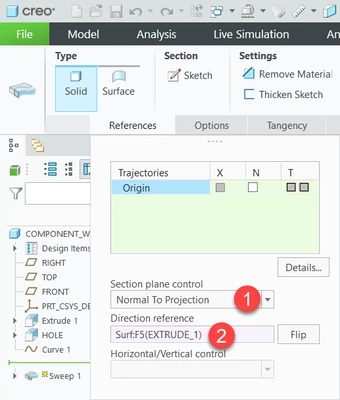

I may not be understanding the design intent of the swept geometry. Could you clarify the comment above about a rotating projection?
I only have Creo 7 or Creo 9 installed. I swept the section of the face using the normal to projection option (using DTM Top as the reference) which may not be accurate. I have enclosed a neutral file here which you can open in Creo 8.

Please see attached zipped prt file. I simply want to protrude the circular face along the helical curve. Thanks.

Jan 18, 2024 4:22 PM UTC
Does this appear to represent the desired geometry?
