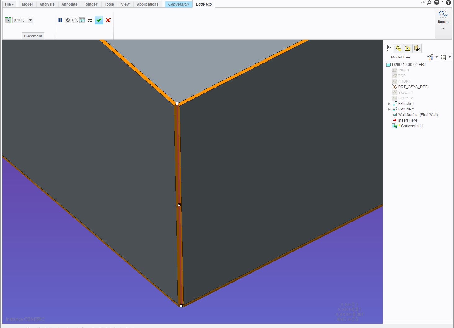

how to create sheet metal part from solid part if the surfaces are intersected not in right angle
kdirth
June 30, 2015
You need to use Conversion from the Engineering menu area and create Edge rips for each of the four corners to complete the conversion to sheetmetal.

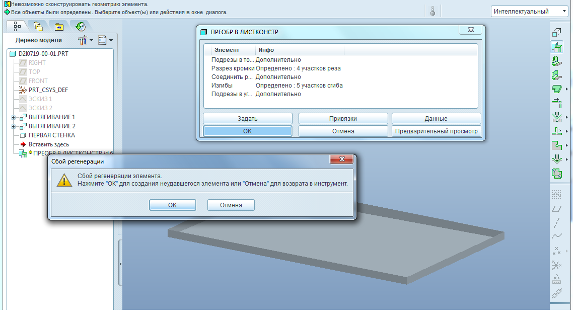

This us the issue to use Conversion to get the target.
it must contain additional terms, but I do not see how to do it.

Not being able to read the language, I can only guess at what the problem is.  Using the Conversion tool, select edge rip and select all four corners that need to be opened.
Hope this helps.
