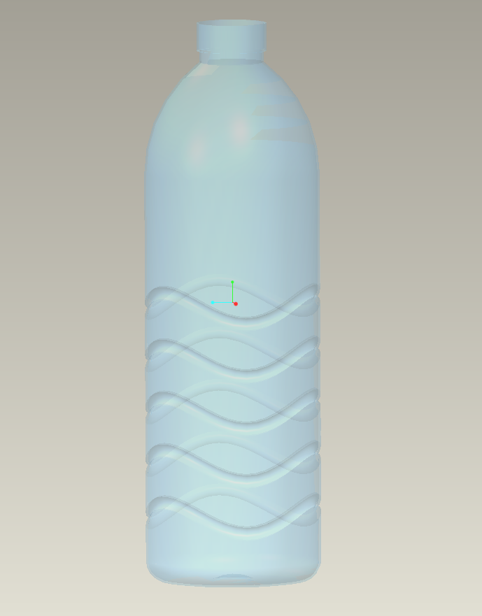

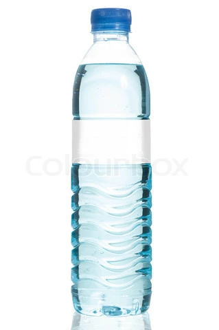

Can any one know I to create wavy surface bottle in Creo.
I have attached the image for reference.
It will be great if any video is available.
Amit

Amit...
This looks like a simple sine wave pattern. I don't have enough time to do a proper tutorial but I can give you some quick guidance:
  1. Make the bottle as a SOLID revolve (ie- do not attempt to model the wall thickness of the bottle). This is the easy part.
  2. Next, create a curve using an equation. This may be easier using a cylindrical equation incorporating the sine function.
  3. Create a cut along the curve created in step 2.
  4. Use a Geometry Pattern to pattern the cut. (There are other patterning methods such as grouping the curve and cut from steps 2 and 3 and then patterning the group, but geometry pattern is better and faster).
  5. Use the shell command to core out the bottle and achieve the correct wall thickness.
Seems like it should be easy enough... the toughest part will be getting the right equation for the curve. Someone smarter than I will be along any moment to supply it... I'm sure of it!

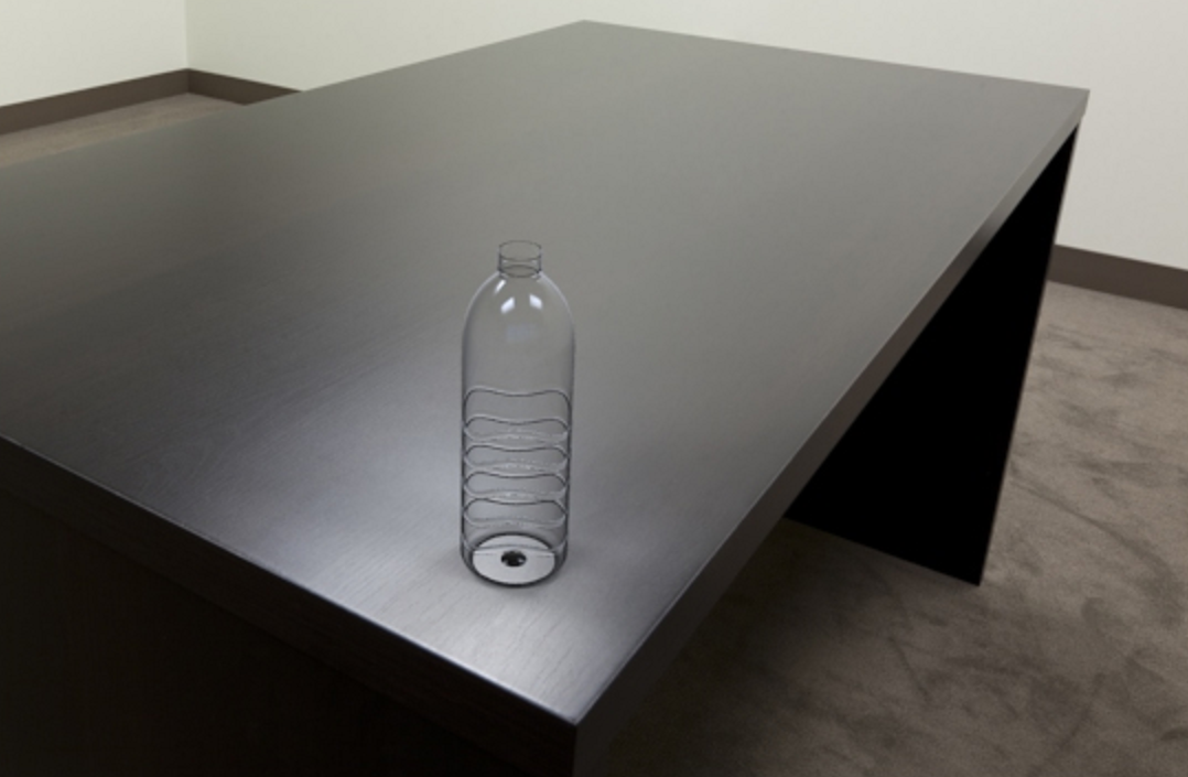

May 27, 2014
I have to stay off PTC Community for the next few weeks... it's posts like this that derail my attempts to get anything done!
Okay so I couldn't resist modeling this thing. I've attached the model in Creo Parametric 2.0 for you to play around with.
Using the exact technique I suggested above, here's what I came up with...
Or... rendered more beautifully by Keyshot....
Amazing what you can do with 5 minutes and great software.
Thanks!
-Brian

June 2, 2014
Hi Brian,
Thanks a Ton !! Its working
