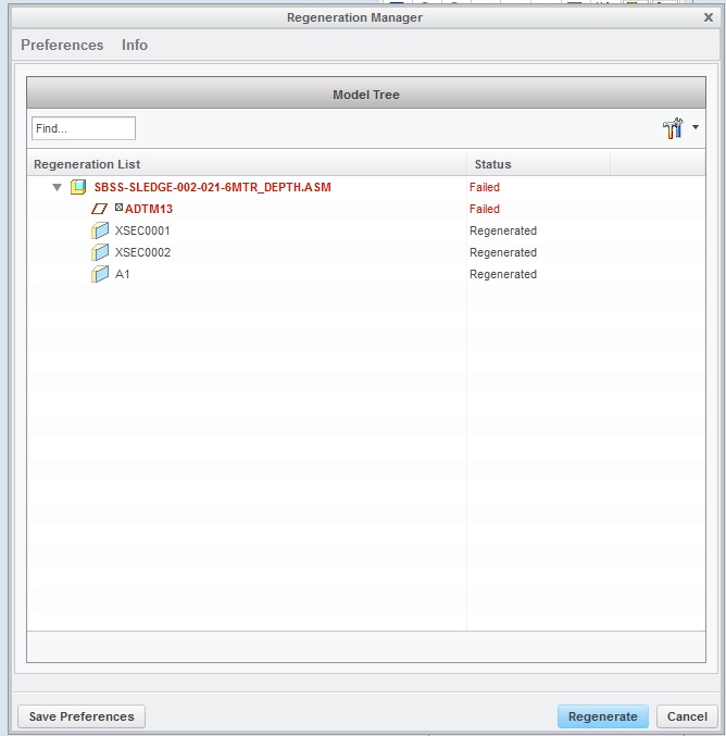

Hi, i have a fail datum plane in an assembly? and now i don't need it anymore. How do i delete it?delete.jpg

If that datum plane has no dependent features then you will be able to delete it.

i cannot find the features in the assembly... so how do i delete it?
February 13, 2017
Ok. then may be this datum is created as an internal datum to a feature and so it is not visible in the model tree.
Try to use the Find tool to search this datum and locate the feature that is using this datum.
