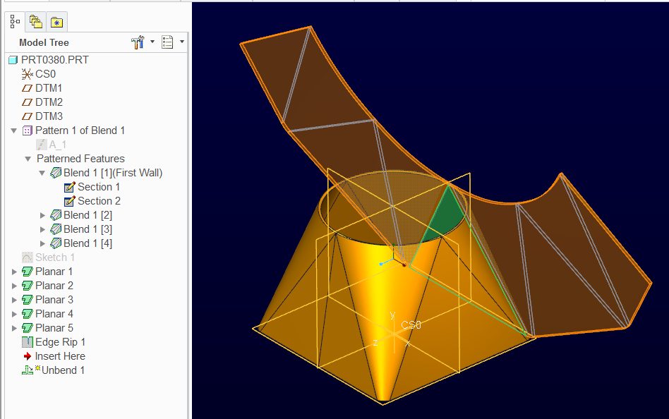

how to flatten this ?
made in creo elements/pro 5.0
    Best answer by TomD.inPDX

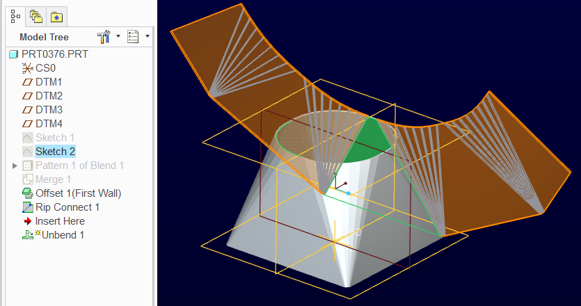

    And if the facets are not desirable... and you want a true round top, this was the best I could come up with:
    The corners are blends, and the planar features are the flat triangles.
    Did you want the Creo 2 part of either of these?

    has anybody tried this?
    i was surprised when i was not able to make this with boundary blend.
    July 26, 2014
    We did have this discussion before. It can be done with sheetmetal.
    July 26, 2014
