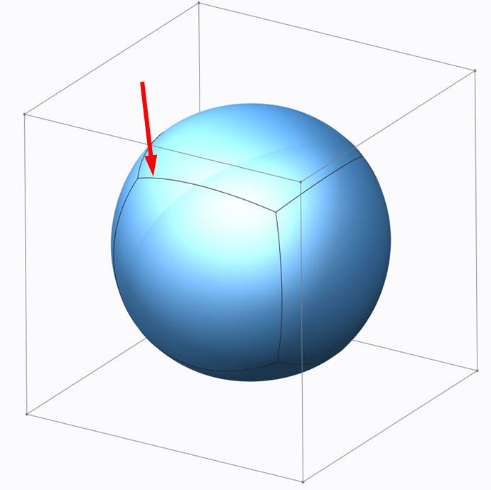

In Damian's freestyle video on youtube (http://www.youtube.com/watch?v=02qZ6Ez1zpI), the mesh is visible on the surface. How does one enable this?
When I started a primative, I only see the control box mesh...no mesh on the the surfaces.
Matt

Change your display setting to shading with edges.

Maybe I misunderstood your question. Are you referring to these lines?

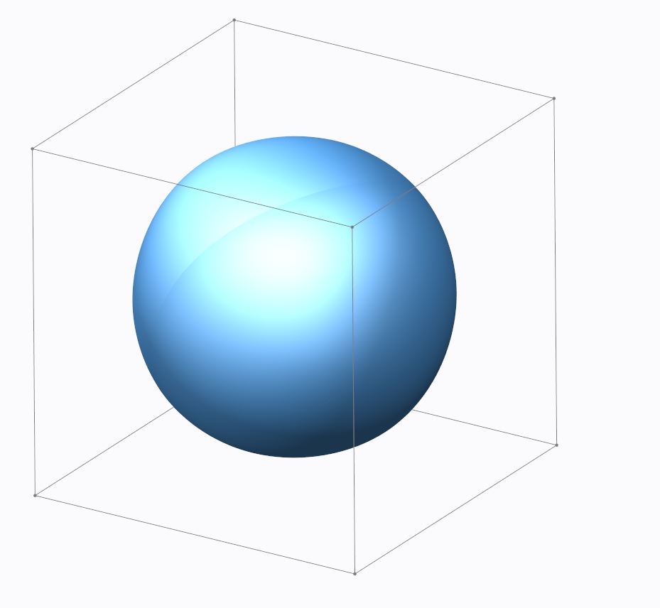

If so, then they show up once shading with edges is enabled. Just shading, no edges, shows this:
