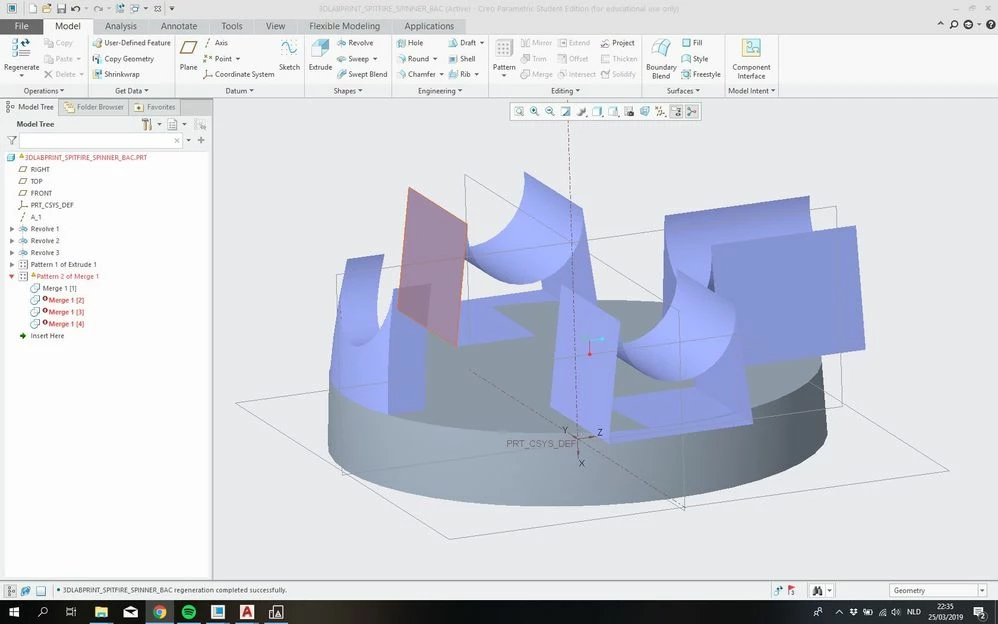

Hey guys,
I recently started working with Creo 5.0 parametric for school, so I am very new to this (I do have a background in Autocad)
I stumbeld upon a problem whilst making a model.
I need to make a pattern of a merge from an extrude with a resolve.
As you can see in the picture only one of the 4 tabs is how it should be. the pattern of the merge has some sort of error.
I tried to search for a similar problem but could not find one. The closest I foud was this video:
https://www.youtube.com/watch?v=PPXoEheaa74&t=8s but it didn't really work for me
Can somebody help me please?
Thanks in advance
March 26, 2019
maybe Geometry Pattern will help.
March 26, 2019
You may try copying the quilt after merge and then pattern the copy.
