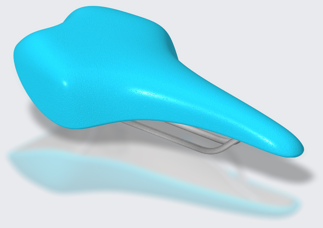

Another example that might be more applicable to product with respect to ground reflection.  In Creo rendering there is no way to control the percentage of reflection on the floor plane.  When a user first learns to render they usually apply floor reflections 14% or higher when in reality a highly polished floor would rarely present past 2% in these examples I present a screen capture of the same bike seat (not even a render) and muddy up the reflection some.  In other renders Ill had some noise to the floor to add swirls also in a layer in Photoshop.
Screen shot default
screen shot with the reflection blurred a bit using Photoshop to soften the reflection.  Just posted this
Image on the design engine instagram D E S I G N - E N G I N E instagram.com/designengineeducation/
