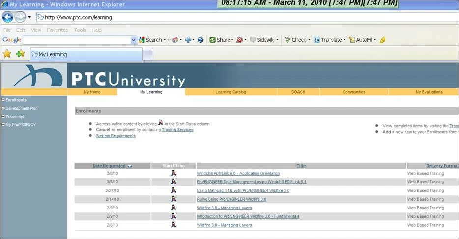

March 11, 2010
Sujay
Yes I can.
Skeleton model technique
1.Draw the sketch
2.Publish Geometry
3.Create part, copy the geometry(External) from skeleton.
This method is correct. As we create a external copy geometry in part, It will not refer any top level assembly if we "check in" any of the part in PDM link.
More details you can check with this website. You have to register .
[cid:image001.jpg@01CAC0F3.AB7296C0]
Let me know if you want anything still
