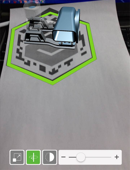

Hi all,
  In Creo 4.0 M010,It can creat ThingMark,and Print ThingMark.When I publish modle,it can scan in Thingworx view by iphone,But it can only scan modle,have no other informations,I search some infor in PTC Univercity Leanrning Exchange,it need edit in Vuforia Studio.But when I login Vuforia offical website,I can't find vuforia studio install pack.How to edit Creo AR modle information?
April 7, 2017
You should be able to get Thingworx Studio Trial from this page: ThingWorx Studio Free Trial
But published Creo AR experiences are not supposed to be edited / enhanced, they're just for a quick view / discussion / collaboration on the model being designed.
