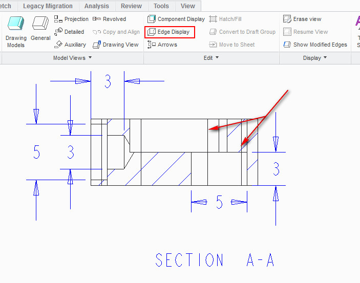

I want to remove specific edges in the drawing file on a section view but not able to do so.
I tried Edge Display Tool but it is not working. How it is possibe please help me in this regard.

Those are probably not edges. Section A-A must be a offset section. These are the division lines for where the offset jogs. I haven't found a way to control these.

When I Select from pick from the list it says Surface F12 Extrude 4. Check the image.
It means we can not use Edge Display command to clean any specific line, so for what it is meant for.
In Autodesk Inventor any line can be selected and turned off its visiblity on the right click context menu and change of colour as well. I was trying to find similar function.

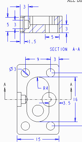

bduncan17-PeridotAnswer
July 5, 2014
QQ%E5%9B%BE%E7%89%8720140705155222.jpgI think you should check it here
July 5, 2014
Thanks a lot quite a useful response, I was able to follow it easily. One more question I want to ask which tool is used to place centre mark and centre line representation in drawing sheet as you have showen in your image.
