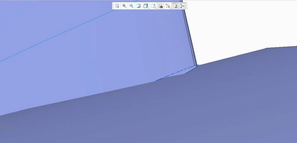

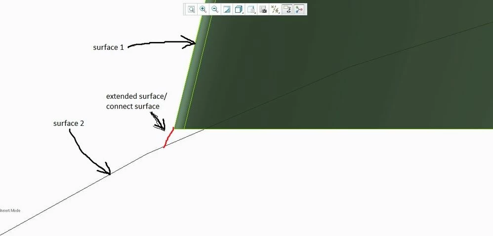

Hello everyone! I have a problem with two surfaces that won't connect to each other.
When i click on Surface Connect and click my Two surfaces.. Nothing happens when clicking ok.
Is there a possibility to solve this problem? Thanks in advanced!

I don't open RAR files so I cannot look at your model.
You can extend edges of your surface until they intersect as you want.
March 23, 2018
You could use Extend with "Tangent" option with Measurement "Along Edge"
