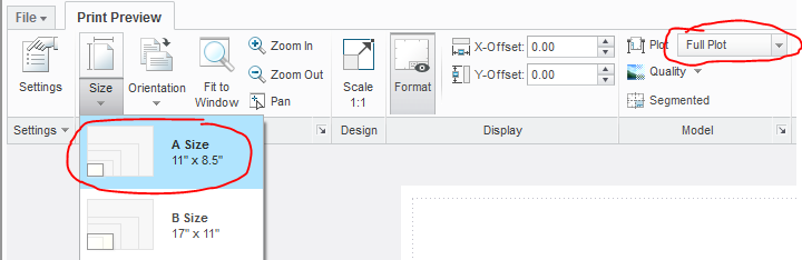

In my company, we're doing a lot of custom sized drawing.
So I want to know if it's possible to create a format fitting to the drawing paper size. And how, if yes.
I don't want to create a new format for each new custom size I need.
October 28, 2015
When a format is larger than the paper size, Creo will (or at least is supposed to) automatically fit it to the paper size.  Just make sure you pick your intended paper size for output and have the plot set to "Full Plot".
adeguy1-VisitorAuthor
October 28, 2015
But the paper scale and the drawing scale doesn't match with this solution.
October 28, 2015
Correct.  If you want to make sure the paper scale always agrees with the drawing scale, then you should only use formats (and drawing sizes) that exactly match the actual paper size.  In that case, you would only need a couple of formats (A and B) and then simply adjust the drawing's scale so everything fit.
You can't have it both ways.  Either you reduce the drawing scale so everything fits on your paper sized format, or you leave the drawing full scale, use a big enough format so everything fits, and then let Creo scale it all to fit the selected paper when actually printing.
