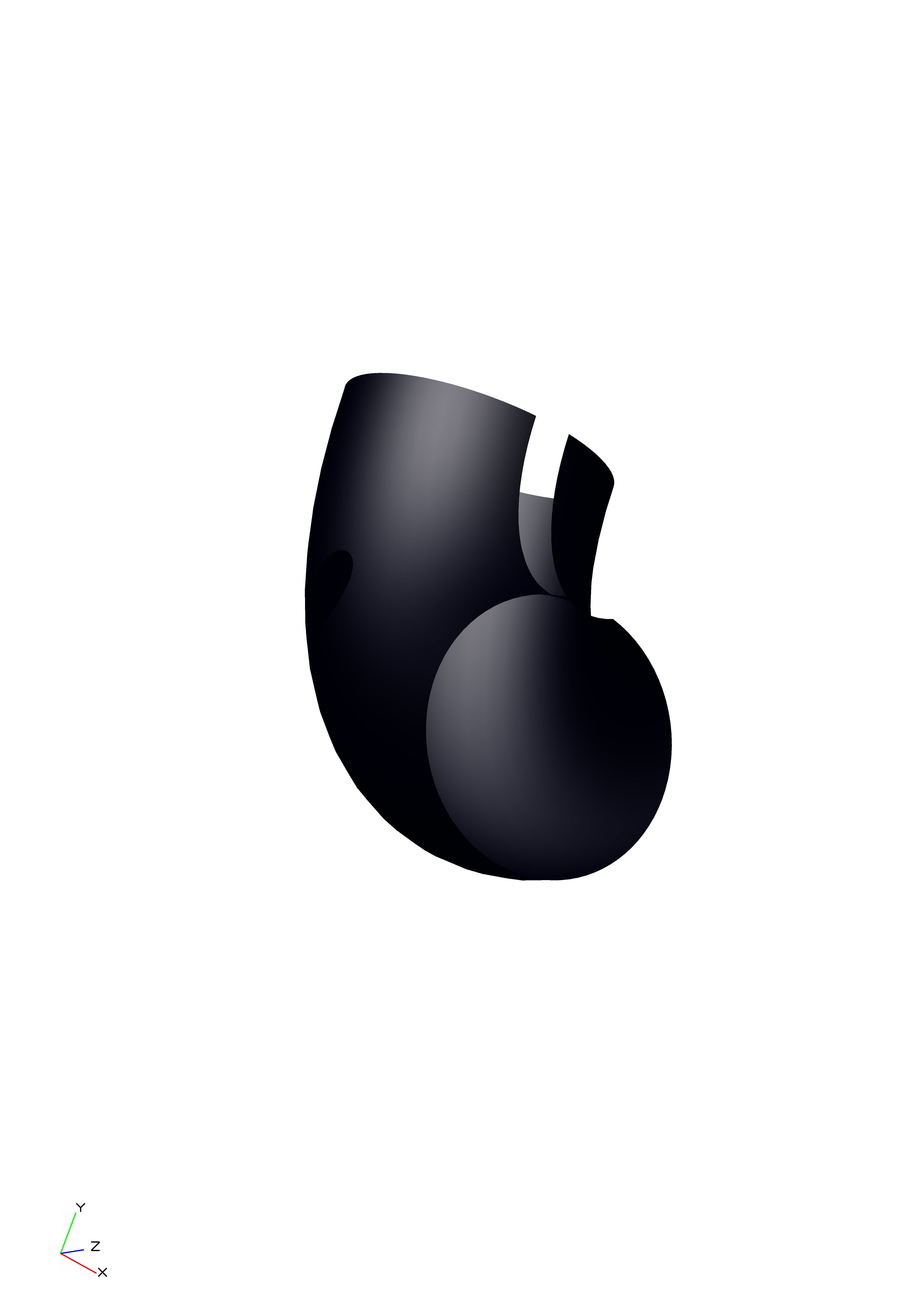

Hello all,
Am trying to find a way to flatten a 3d curved surface of a pipe bend. It has a split down the middle to break and am looking to find the flattened shape.
Any ideas or thoughts greatly appreciated.

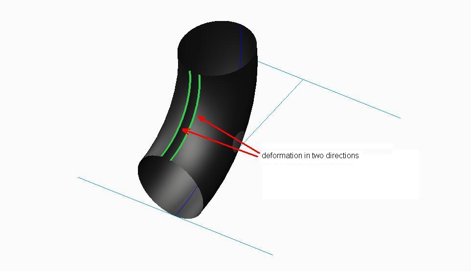

Hi Andrew
It is not possible create correct straight surface from your model - because flattening is in two directions:
