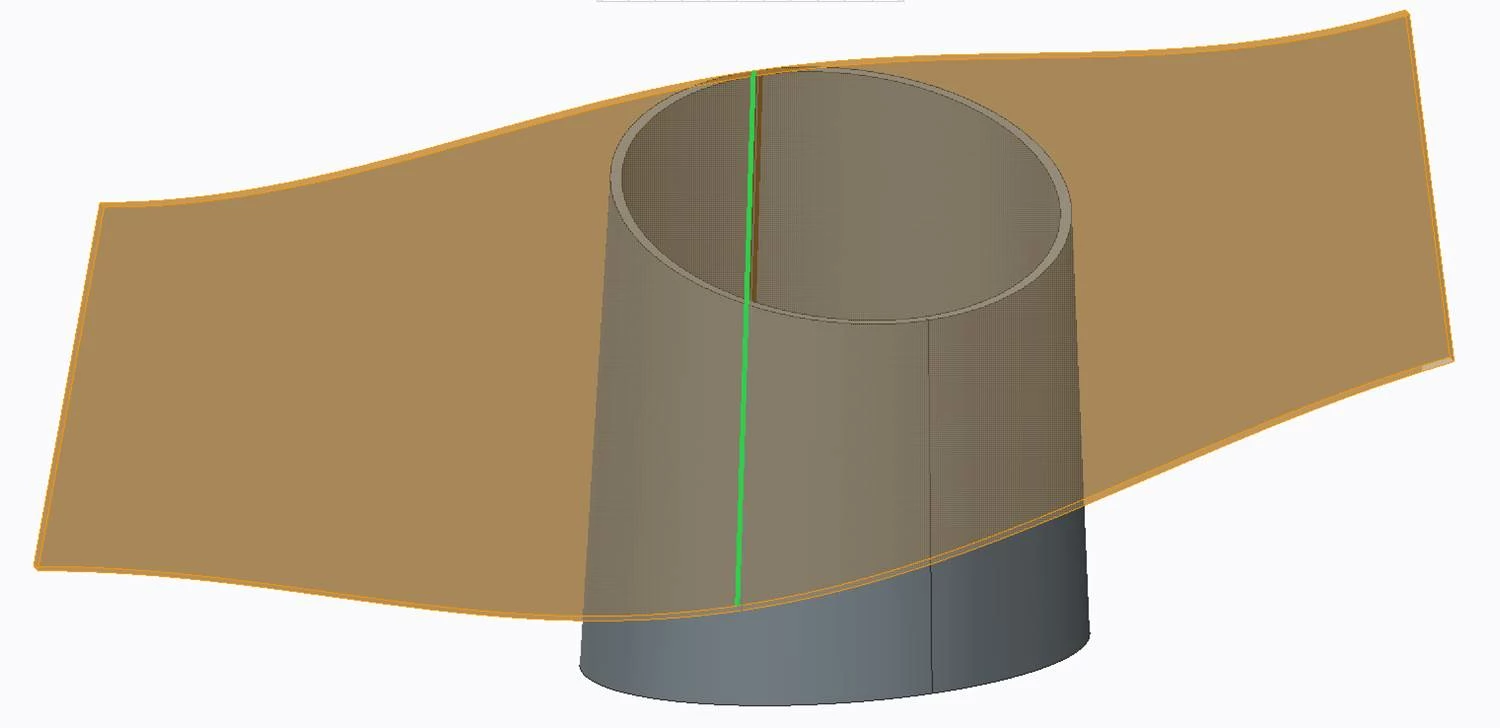

how to flatten this?
  • February 26, 2014
  • 1029 views
how to flatten this? I have attached the part file with this.
February 26, 2014
I think you'll have to redo this part and start with a sheet metal revolve. I was able to reproduce your part this way. See the attachment.
The flat makes a pretty interesting shape.
