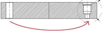

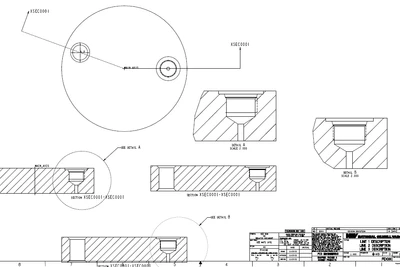

Good morning,
Refer to the above screenshots, where is the switch in CREO to turn off the ghost lines so that I can print and issue the drawing to production?
Thanks.
Best.
JS

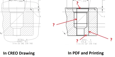

I don't think I have seen lines just appear like that. Is there geometry behind the port that would look like that?
Sometimes surface quilts show thru or cosmetic threads but you usually see them on the creo drawing and not just on the PDF.
You may try to turn you background to black using File - Options - system colors and there is a drop down box for "white on black" just to verify that its not somehow white lines on the white background.
November 22, 2021
Hi Stephen,
See below, the ghost lines belong to a thru hole on the other side, however, there show up in the detailed view not in CREO drawing mode (note: I did check both "white on black" and "black on white". In fact, I worked whole day on last Friday with "white on black" setting), but in PDF print out.
Thanks for replying. (This is CREO 6).
StephenW
November 22, 2021
I can't recreate the problem. I tried fully aligned and full unfold x-sections. I got nothing similar except one of the thread lines missing in the the un-fold x-sections.
Its some kind of glitch based on the section but not sure how to fix it.
