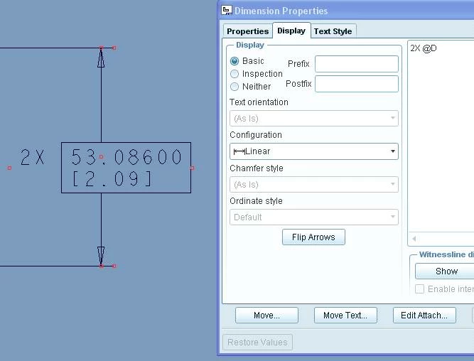

Hello i was using Pro-E WF3 till date and sincecouple of days i'm using Pro-E WF5. And i'm facing an issues with basic dimensions, like in WF3 for basic dim. with number of instances we have a provision of wrighting that 2X 50.5 into a box. But in WF5 the 2X comes out side the box. Which is irritating me. Hence please help me how to make as WF3, means all should come in a box for basic dimensions as below
Example
2X 50.5

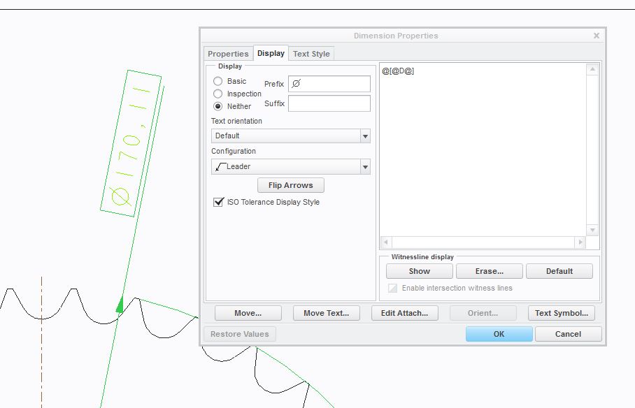

The following picture is from Creo 2.0, but I guess this should work in WF3 as well.

But if you insist, You can add that to Jakub's method.
June 27, 2013
It can go inside the box. You can look on the cover of ASME Y14.5-2009 and see that they put the 8X inside the basic box of the 45degree symbol.
