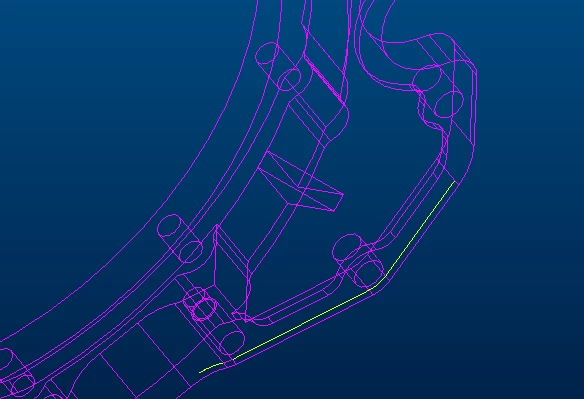

Dear friends,
I am struggele two days to repair a imported model to solidify it, up to end I am surrender by last one green line. My firend, can you please show me how to del or modifly the imported model which can be solidify to get model mass, thank you very much.
My Proe is WF4.0

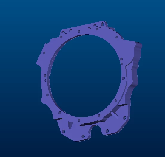

Best answer by ptc-4763147
What´s the problem? It is able to repair it and solidify is posible.
I thing i done it this way:
delete surface that are unuseful
detach all broken surface and merge them together
when it is´t able to merge it i use collaps two groups of surface
in four/five step finished
i can write it better way but i don`t know where is main problem
bye

Hongjie1-VisitorAuthor
October 11, 2012
thank you John, you did it.
my problem is I do not know how to handle the green line. can you make a few sceen shot or vedio show me how to do it, thank you very much!
best regards, Hongjie
October 11, 2012
There is a pdf tutorial in the reference documents under ptc support.
It tells you what action to take in which situation...
