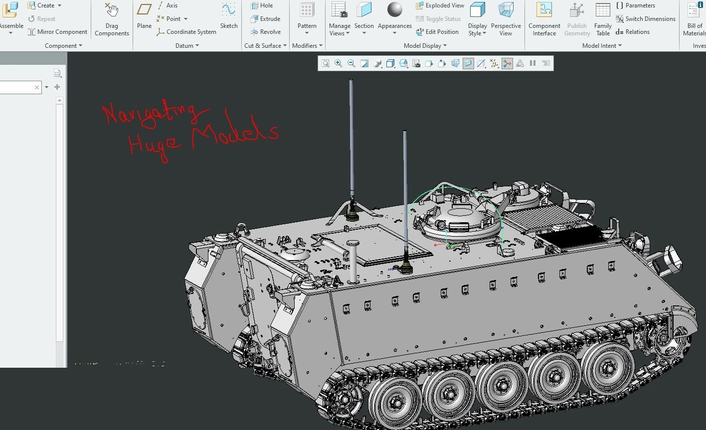

How to improve fact navigation with your existing graphic card
What settings in CREO would allow me to fast navigate a BIG assembly? Any secrets any tips will help. EXISTING is frame by frame slow movement of the assembly.
Thanks in advance for your reply.

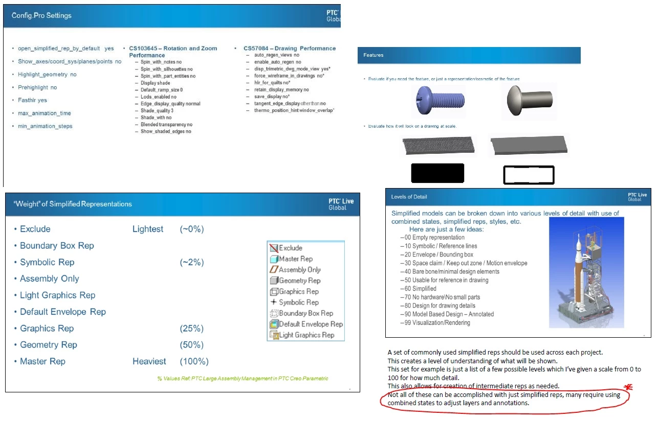

I seriously spent some of my work time to quick browse the PDF presentation as it caught my attn and my next step is to focus more Indepth on the one pager I attached. This is what I squeezed out of the print. Your thoughts
