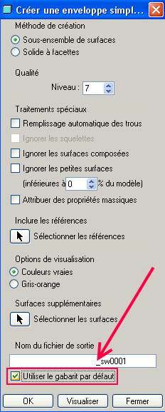

I've duplicate "shrinkwrap_facet_export.ttd", for create "shrinkwrap_merge_export.ttd"
I modified this file with "notepad"
The batch files is good, but I don't know how to add the function "gabarit par défaut" in french
I think it's the function "datum_refs", but I don't know what put.

<assign_datum_refs> ??? </assign_datum_refs>

Maybe use <TEMPLATE_OBJECT></TEMPLATE_OBJECT> ?
