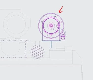

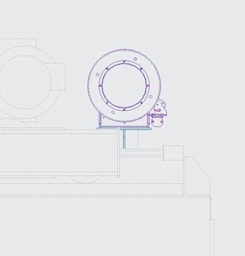

I am using Creo Parametric 7.0 and am making a drawing and one of the parts in the assembly has been imported from a .step file. When I take a section of the assembly, the imported part instead of showing just solid lines, shows all of the quilt lines in magenta and purple. So essentially, you are seeing through the part, no longer just the nearest surfaces to the section plane. I have found some threads about using the import data doctor and have tried to make it a solid part, but have had no luck.
Is there a way to fix this in the drawing itself, or does it need to be done in the part?
The first picture is what it looks like when I take a section, the second picture is what it looks like when I dont take a section (what it should look like).

This is a cross section "thing" when a model has surfaces (quilts).
In the model, edit definition of the cross section, go to the models tab and check the box for Include Quilts
Also, vote for the improvement to add a config.pro option so a user can set it so this box would be checked by default
https://community.ptc.com/t5/Creo-Parametric-Ideas/Config-pro-option-for-Include-Quilts-option-while-creating-cross/idi-p/697199
April 29, 2022
The problem with this is that I need the part to show in the section view. If i check that box the entire part disappears. I need it to show up, but as a solid body.
StephenW
April 29, 2022
The part should not disappear completely but should x-section with the correct hidden lines. Of course with a surface model, there will be no section lines since there is no solid geometry.
You may also have to go to the view properties, View display and check YES for hidden line removal for quilts.
Your best option is to get the model as a solid but you may be able to work-around the issue if you can't do that.

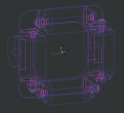

I think I have narrowed it down to the .step & .iges files that we are using to create parts are having issues with the quilts and having open surfaces and will not coming in as solid parts. I was able to get some of the parts to solidify, but some have open features and are not working. I have tried to repair them with no luck. Attached is a file of an example. Is anyone able to make the entire part solid? I can make certain parts of it solid, but am not having luck making the entire part solid. I have tried a few things in the IDD but am not too familiar with it and didn't have any luck.

You are correct that your import geometry has non manifold quilts which is why it is not being solidified. The geometry is trivial (cylinders and prismatic rectangles) and the errors are almost certainly caused by the method used to export it.
It can be fixed with IDD but you should try exporting the assembly source file as an assembly in STEP format. Import it as an assembly in Creo. That may resolve the issue.
Every magenta edge you see in this image is open.

As mentioned, you have imported a surface model that is not "closed" into a solid.  You can fix it manually, which can be EXTREMELY tedious and pretty much impossible if you're not fluent in surfacing, or, you can try my personal cheat:  If you have Solidworks, import the file into Solidworks, run the diagnostic and fix it there and if SW fixes it as a solid, then make a new STEP file and import it into Creo.  Since I have both (but only use SW for fixing these files), I've been able to save a TON of time over the years doing this.  SW has a MUCH better "fixer" than Creo, sadly...  If you can, I'd try that first.
