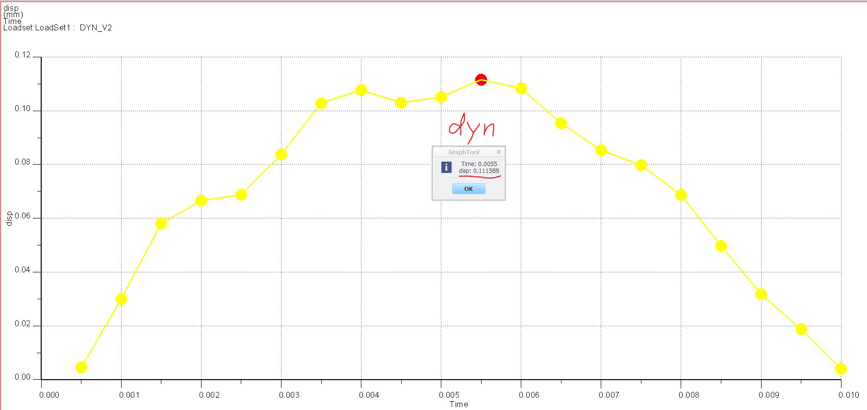

I want to measure support force in constrain surface, it's easy to get it in static analysis, but how to get it in dynamic analysis like shock simulaiton?
I checked below diagram but didn't found there is no force available , could anyone do me a favor, thanks.
Best answer by skunks
V2:
dynamic sinus shock 50G (5% damping) / user defined:
s_dyn=0,111588mm
static 1G:
s_stat=0,002175
s_dyn/s_stat=51,3
force_dy=51,3*3,611186N=185,3N
skunks
May 3, 2017

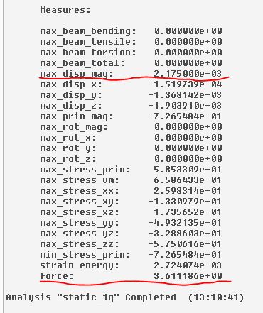

workaround (attached)?
measure:
then static analysis
regards
paul

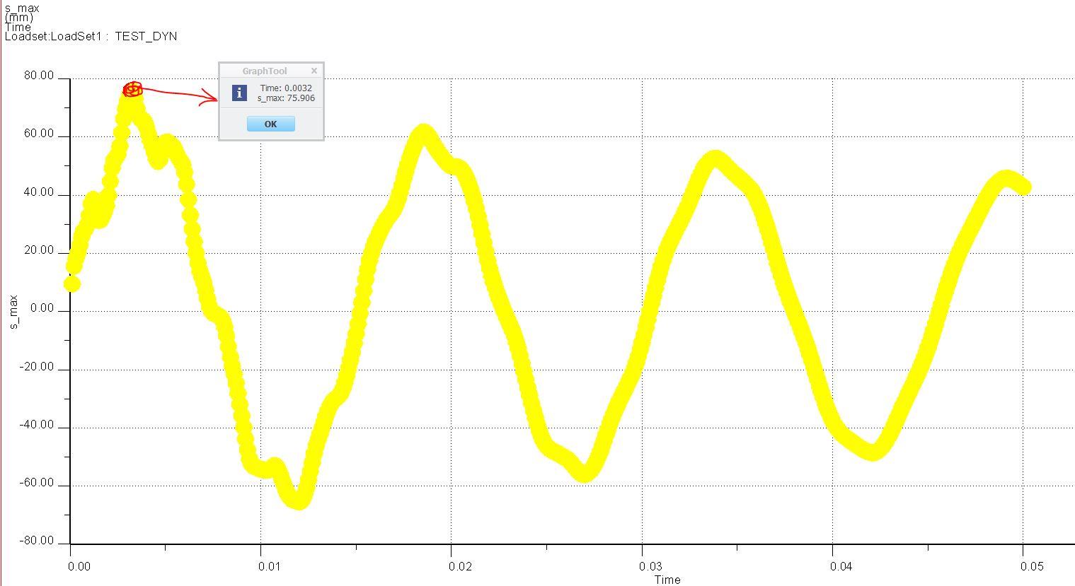

Thanks for your answer, now I understood the situation you mentioned. but what about below sample
I supposed this sample is fixed on shock-fixture by front two screws(x,y,z constrain) and rear support for y-direction.
And then do 50g half sine shock. so it's hard to get clear displacement as your sample. so I still don't know how to calculate the support force on rear side

skunks19-TanzaniteAnswer
May 3, 2017
V2:
s_dyn=0,111588mm
static 1G:
s_stat=0,002175
s_dyn/s_stat=51,3
