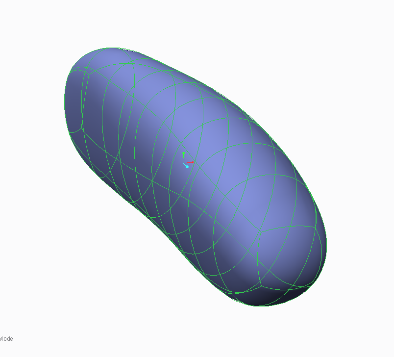

I have just been sent a simple geometry that as been made with Freestyle in Creo 2 Parametric.
I would like to know if it is possible to merge the individual quilt surfaces together, so that a single decal can be applied to the entire model. This is the decal I would like to apply;

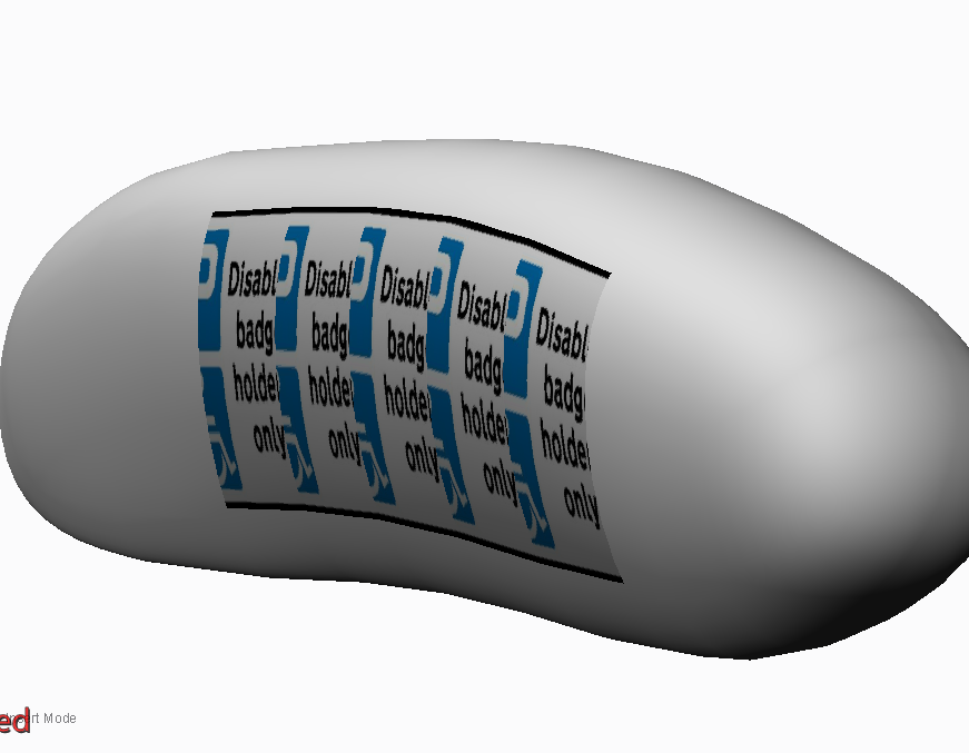

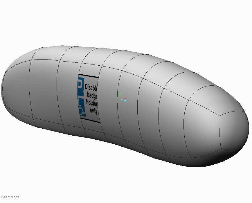

At the moment, I solidifiy the Freesytle, but as I can not merge the surfaces together, I end up with this
As you can see, the decal is only applied to one of the quilt surfaces, and I require it to be displayed on the entire model.

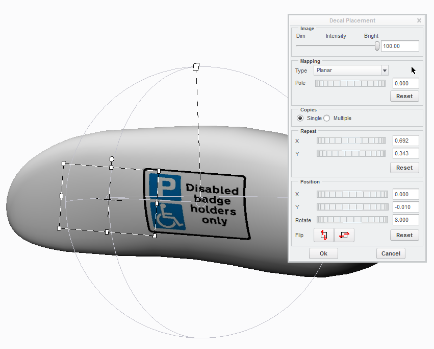

Best answer by bhogan
Hello everyone,
I have had a play and I believe I may have solved it, with advice from Doug Schaefer.
If you apply the decal using 'Planar' mapping type, seems to apply the decal to the selected surfaces.
Thank you to everyone for the help!

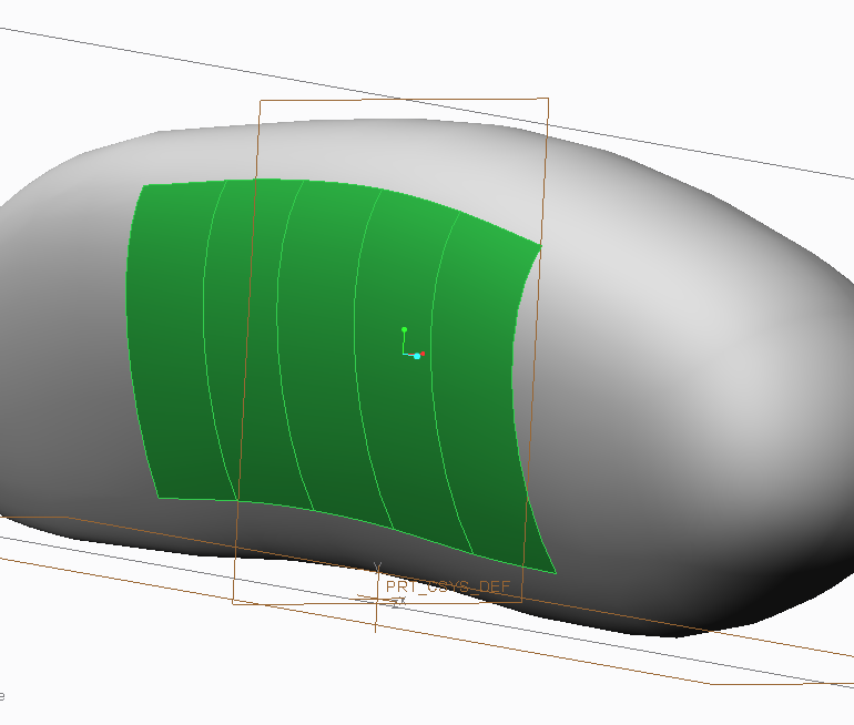

I am aware of the technique you describe, however I beleive this does not help, I can multi select the surfaces to apply the decal to,...
but as they are separate surfaces, this is the result;
As you can see, this is not what I am after. I require one, single decal, on the entire model.

Have you tried copying the required surface set, & applying the decal to that?
