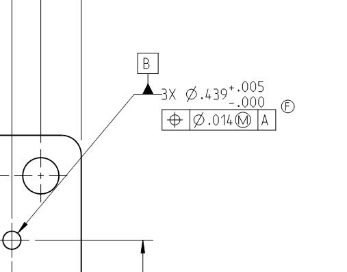

Hey all,
I am on Creo 2 and I am running into a problem where I am recreating a drawing and I can't seem to get the leader line to stick with the dimension, it always wants to go to the GTOL as soon as it is created. I beleive this is also the root cause to why I can't get my B datum in the right location.
I created the GTOL is a small assembly (2 pieces a base and weld nuts) then brought it into my drawing and regardless how many different ways I do it I still have the same result.
Any help would be appreciated!
Sam

Creo, even in a part as ASME Y14.42 3D GD&T, is not allowing me to create the following example...
http://www.geotolmeadows.com/newsletters/2012/pic1.jpg
StephenW

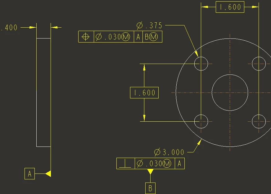

Jul 9, 2014 1:37 PM UTC
That's funny, I didn't realize I had done it the way the original question was asking for.
I simply added the GDT frame to be attached to the dimension in the definition box.
I have never seen Creo allow you to attach the "B" datum to the leader of a dimension as show in the original image though.

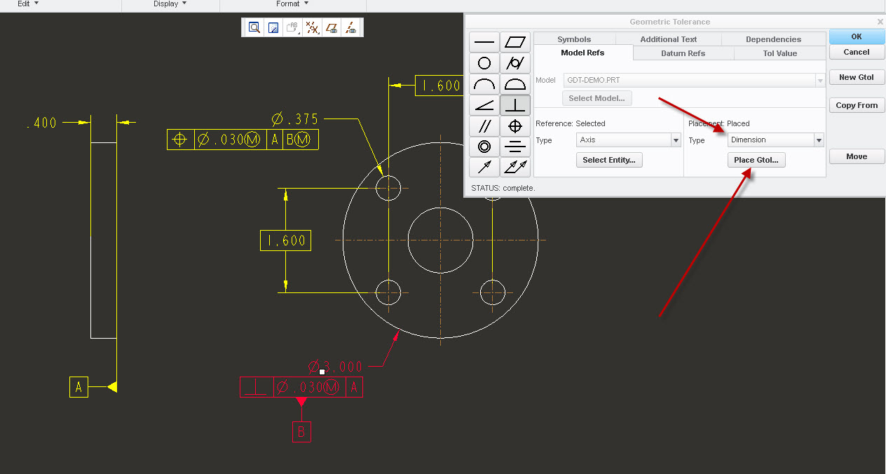

Aug 23, 2019 11:40 AM UTC
File --> Prepare --> Drawing Properties --> Detail Option
In "Option", Find for "gtol_datums" , Set Value as "std_asme"
