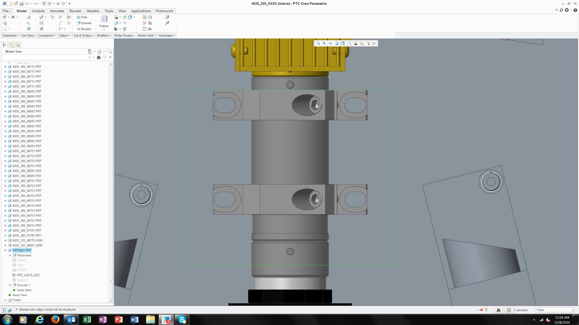

Greetings:
I am a new user been using Creo for 6 weeks, I come from the SW /Inventor/ Solid edge worlds.  During my time using Creo I'm struggling to master some of the most basic modeling features that were relatively easy to create with the 3 CAD packages I mentioned.  One issues that I can't seem figure out after 8 hours is how to place a tapped hole behind a thru slot on another part.  I know how I would accomplish this on other programs but I just can't figure it out on Creo.  below is a screen shot what I'm discussing.  If anyone has a step by step approach it would be greatly appreciated,  -Frank

I imagine someone else out there might have an easier way, but I would create some simple construction geometry.  My preference would be to create a axis in the clamp that represents the slot center, and then use this axis as the second reference for the hole feature.  If you can't (or don't want to) modify the clamp, then you could also create similar construction geometry in the part getting the taps.

This is very much a common practice on slots.  In the sketcher there are 2 point types; geometry and construction.  In the datum area of the menu, these are geometry and can be referenced after the sketch is closed (but visible) where construction geometry (points, axes and Csys) are only visible within the sketch.  In extrudes, the geometry points extrude to datum axes.
Placing points is easier when you open the dialog tab.  There are a lot of options hidden below there.  However, Creo is weak on "midpoints" locations.
One thing... is it your practice to use assembly references in sub-models?

Not sure if this was all directed at me or the OP, but yes, there are always 20 different ways to accomplish the same thing in Creo.  To answer your assembly reference question, I imagine there are (at least) four different methodologies here:
  1. Create some extra geometry in the clamp (axis, point, curve, etc.) and then reference this from the tap. (Modification to the clamp model is required.)
  2. Create some extra geometry in the tapped model and then reference this by the tap.  (Still have a reference back to the clamp model, but no modification of the clamp model is required.)
  3. Create some geometry in the parent assembly (or skeleton model) that defines the tap location.
    • If this geometry is defined independently and then drives both the clamp and the tap locations, you basically have a "top down" design.
    • If this geometry is instead driven by the clamp location, you basically have a "bottom up" design and the end result isn't much different from #1 and #2.
  4. Define the location of the tap manually with dimensions, completely unrelated to the clamp location (no references.)
Option 4 will provide actual dimensions that can be shown on a drawing for the tap location.  Options 1 - 3 will not, since the tap location will be coaxially tied to the referenced axis.
I personally prefer option #1 since I can be confident that if the clamp moves position, the tap is going to move with it, and I don't need an abstract skeleton model to define the relationship.  Granted, this requires manual creation of some drawing dimensions (for tap location), but I think the trade-off is worth it.
To take it even further, if you're willing create your own home-made hole features (UDFs), you can have the tap size automatically change when the clamp's screw size changes.  Then both the tap location and tap size will correctly update when the parent (clamp slot) changes.
