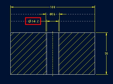

I have a question regarding threaded holes.
Is there some option (in .dtl) to set-up the hole diameters not to be shown in drawing by default (in this case 14,2)?
Thnx
T.

August 18, 2014
You must be running an older version. In Creo, you can choose what to show. in your case, you either hide it (show/hide - WF) or erase/delete - new dialog.
August 19, 2014
I am running on Creo Parametric M030.
I thing i was not clear with my explanation - I know the show/hide option can be used to hide the dim., but since that dim is usually not shown in drawings i would like to ask whether there is some possibility not to show it by default.
It is just quite annoying if there is lot of threaded holes in the drawing and all those useless diams have to be hidden.
August 19, 2014
In that case, no. I get a lot of useless dimensions. Angle dimensions seem to be prolific in my parts. How often do you need a 360 degree or 0 degree dimension 🙂
