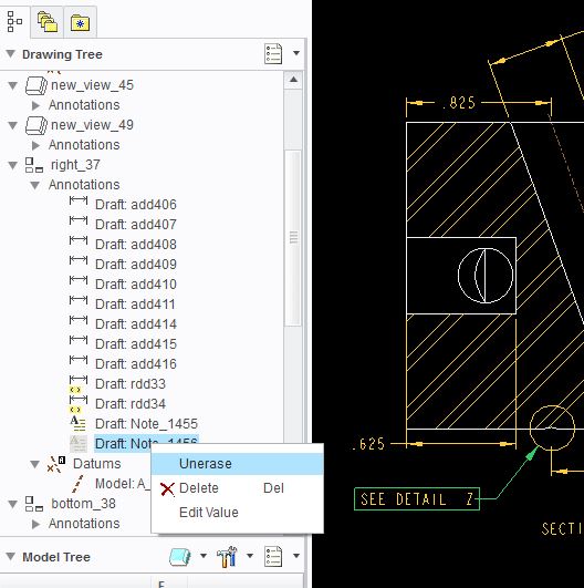

August 5, 2016
I just discovered this one in CREO 3 M070.
Right click on the view or on the name of the view in the drawing tree and select the ADD VIEW LABEL.
