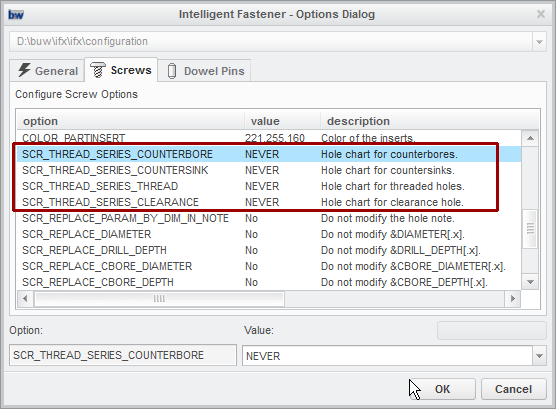

I think this is a Creo problem. As you already mentioned you tried to create the holes by yourself as assembly feature holes. If this takes the same time, so IFX cannot speed up the creation. 2000 holes are really a lot of holes - so this might take some time.
There is no option available to create points instead of holes. Even if we had such a option I think this will need the same time.
There only exist a option to create no holes at all. Just set NEVER for all four SCR_THREAD_SERIES options.
What do you mean with - "... assemble screws instead of hole?"
Idea:
Maybe you can split up your assembly into smaller subassemblies to reduce regeneration time. Then you can activate or open your subassembly and assemble your fastener.

I have tried it on my end with a very small assembly and a point pattern with 2000 instances.
And you are right - this really takes long.
Even if I only select the pattern to highlight the fasteners it need a long time to highlight the fasteners.
