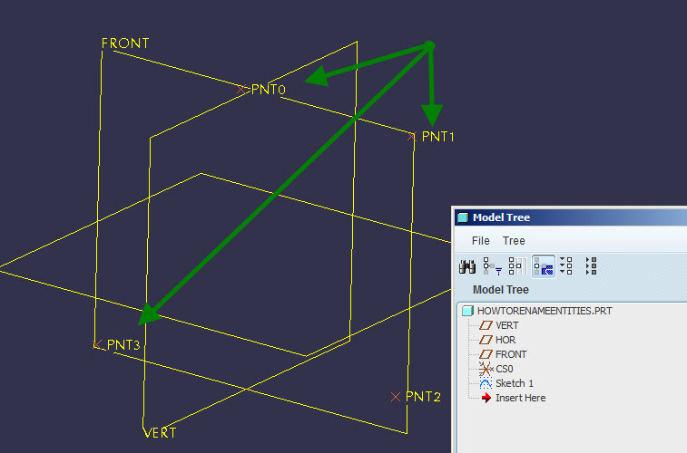

Suppose a sketch contains 4 datum points. I know how to rename the sketch, but I want to rename the individual datum points as well.
See attachment as well.
In the old WF3 (never used WF4), there was a menu under Feature Operations to rename individual entities. We used mostly to rename datum planes in a Copy Geom.
Regards and thanks in advance, Hugo.

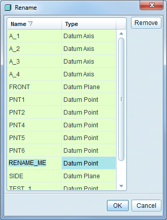

Best answer by TomU
File, Properties, Names.
TomU23-Emerald IVAnswer
September 26, 2014
