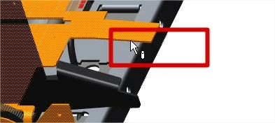

in CreoView 3.1 , it was possible(connected to Windchill) to see the part number of a part just staying on it in the graphic window.
we have now CreoView 4.0 F000 and I don 't have this feature, and I can't find the option managing it
to see the part number I nee to click to highlight it in the tree

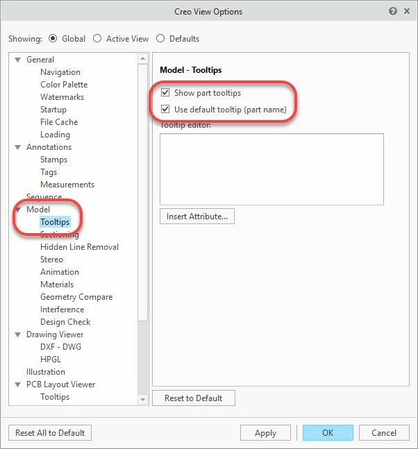

March 15, 2018
Check the Tooltip settings:
