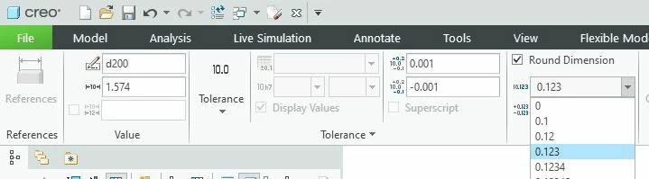

If it is a driven dimension (meaning it comes from the modeling) then you simply double click the geometry that contains the dimension, select the dimension and then change the decimal places as shown below.

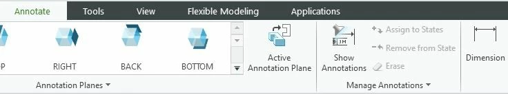

If you use the show model annotations button then you can make this same dimension (with the same number of decimal places) show up on the drawing. If you want a different number of decimal places to show in the drawing then you need to create a created dimension. You can do this either in the model or in the drawing. This will have its own tolerance control that can be set independent of the driving model dimension.
Model:
Drawing:

You can not have a shown dimension that has 2 decimal places in the model and then the same shown dimension have 1 decimal place in the drawing. The software doesn't allow it.
Maybe I am reading your question wrong if so then you need to provide more clarity. Otherwise as I suggested originally, the only other way to do this is to make another dimension or parameter which you can then use on the drawing (with a different tolerance).
Patriot_1776
May 2, 2023 8:16 PM UTC
Use CREATED dims at the drawing level, then you can pick whatever number decimal places you want.  The created dim on the dwg will not drive the model, but oh well.
