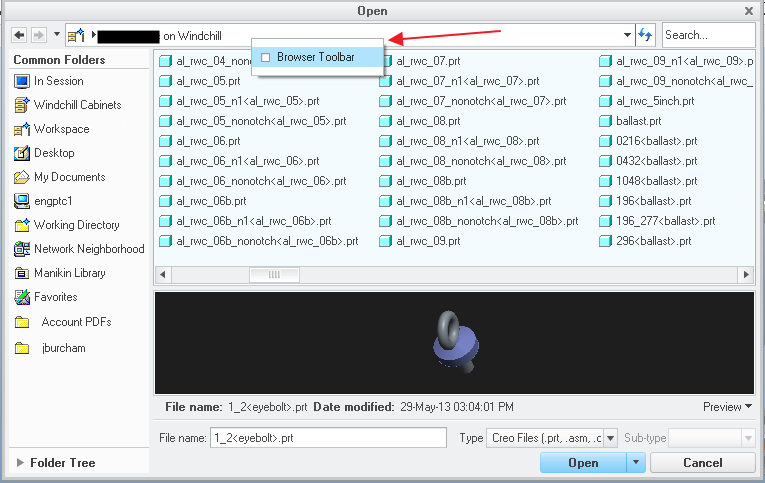

Best answer by JamesBurcham
If you right-click in the address bar you should get the browser toolbar options. Before right clicking make sure the cursor is NOT in the address bar. You can do that by clicking anywhere withing the window.

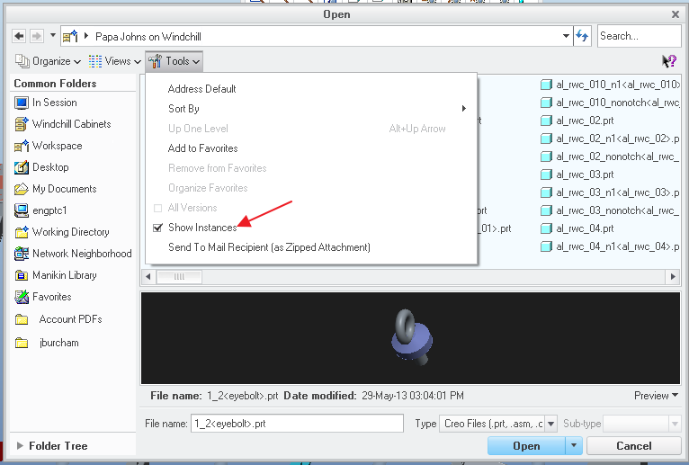

Is this option selected?
December 26, 2013
Perfect! Thanks!
