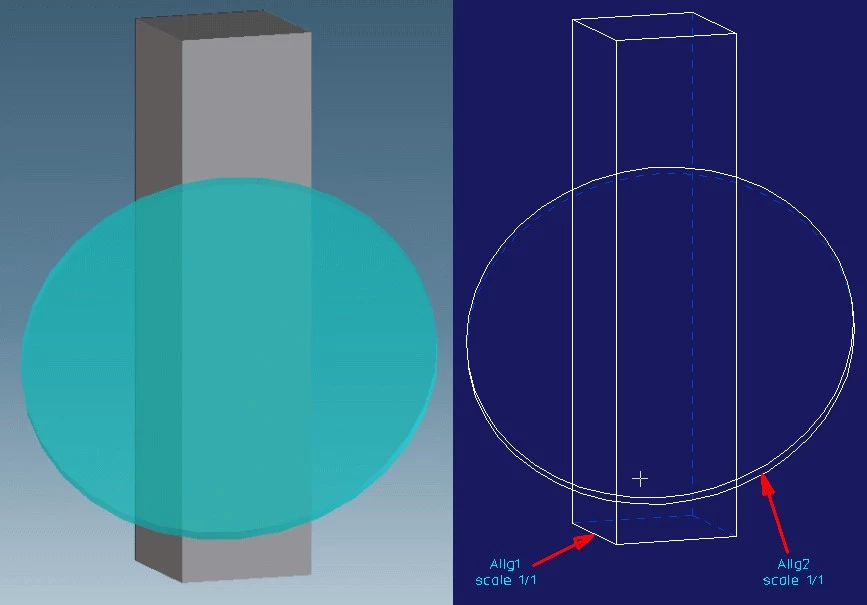

I have an assembly and (1) part is transparent (sight glass). When I set the part to be transparent in the model everything is okay.
But when I put the necessary defined views in the drawing it loses the tranparency and makes it a solid as well as changes the inside features to hidden lines.
I want to be able to show in the drawing how the part actually would look without going to a shaded view. Meaning the glass would be clear (still showing the outside edges as solid) and seeing the inside features as solid.
Does anyone know how to do this?

July 22, 2013
you can use part/workplane geometry styles under annotation>Setup>properties. you have to (manualy) select the parts that are behind the glass and give them the correct color and set the linetype to full.
then update your views (although annotation will not show the views in cyan, this is needed to apply the changes).
i know it's a little cheating and not user-friendly when you need to select a lot of parts, but it does work.
note that hiden lines of the selected parts are also converted to full lines.
July 25, 2013
You could hide the glass in the assembly and create a second view with the glass alone and superimpose them.
