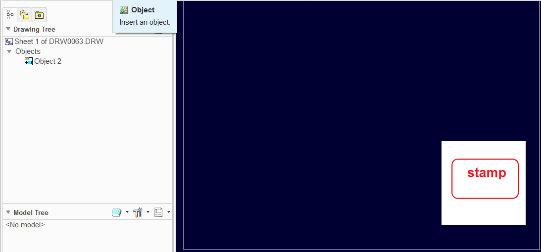

This is more a Visualization area problem - that is the part of Windchill that creates outputs based on Creo models and drawings that are to be looked at and interacted with.
There may be some utility to insert an OLE object representing the stamp:
http://help.ptc.com/creo_hc/creo30_pma_hc/usascii/index.html#page/pma/detail/About_OLE_Objects.html
If can leave the PTC software loop, it is an easy task within Adobe Acrobat Standard or Professional. For that purpose BMP is OK, but PNG is better as the stamp can have transparent elements if required.
As an aside - JPEG is a terrible format for this purpose and worse than BMP. It uses a greater pixel depth than BMP for colors and so, uncompressed, the image files are larger. If compressed, the sharp changes in color result in a peculiar sort of compression artifact, where there is counter-shading at the transition that simulates the gradient though an optical illusion, that examined closely is just an ugly blur. Remember that its the Joint Photography Experts Group, not the Bitmap experts. JPEG was designed to do a good job with noisy pictures with softer transitions and it does a great job at those.
PNG, on the other hand, uses compression that does not do this, leaving the transitions sharp, so even with greater pixel depth the files are smaller than BMP by a lot. In addition, unlike BMP and JPEG, PNG can have a transparency layer that allows fully transparent to variable translucent overlays, mimicing the usual stamped and inked marking that does not obliterate the image underneath.
September 18, 2014
Oh I agree totally that PNG is a preferred format for a lot of things. But as an OLE object in Creo, not so much. All too often a OLE PNG doesn't work on an out-of-the-box installation.
David, can you give the instructions to register the .png objects as a recognized OLE image in Creo?
All I get from PNG files is the filename.
Edit; I tried a transparent .tx4 image (native right?) and it also just puts the file name in a box.
September 18, 2014
Not in particular - I only know that there has to be an Application that is responsible for displaying the filetype. I would guess that the Application needs an OLE interface as well. There was some paint program that was useful as a target, but I don't recall the name off hand. Also it looks like transparency may not be available using OLE - http://support.microsoft.com/kb/123151 I don't know enough about WMF or DiB to know if they support it, but I'm pretty sure the default BMP does not.
