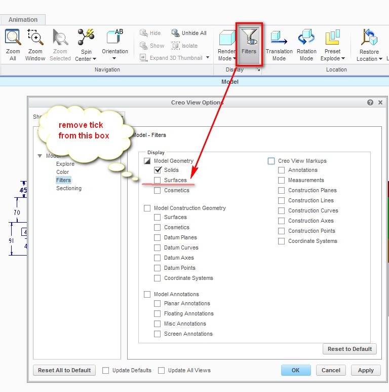

Hello Everyone,
I don't know this is a right place to ask this question. But anyway here it goes.
I use Creo Express View 2.0 to open assembly model, but all the surfaces are turn on. This problem only happened with the models or assemblies that are created in creo 2.0 (the models or assemblies are created in WildFire 4.0 are fine.)
Any help will be greatly appreciated.
DV
Best answer by MartinHanak
Hello DV ,
I tested your files a little bit...
  1. Problem can be reproduced on 74215_bd1.prt, only
  2. I saved this part in Creo Parametric 2.0 M050
  3. Now, Creo View Express displays 74215_bd1.prt correctly (I hope)
I uploaded 74215_bd1.zip...
74215_bd1.prt.53 ... saved in Creo Parametric 2.0 M030 by you
74215_bd1.prt.54 ... saved in Creo Parametric 2.0 M050 by me (no config.pro used)
There are two alternatives:
  1. The problem is caused by Creo Parametric 2.0 M030 bug, which is resolved in Creo Parametric 2.0 M050.
    If this is true, then you have to install Creo Parametric 2.0 M050.
  2. The problem is caused by some config.pro option.
    I suggest you to launch Creo Parametric 2.0 M030 without config.pro, save 74215_bd1.prt and open the new version in Creo View Express.
    If the new version is displayed correctly, then you have to locate the buggy config.pro option.
Good luck
Martin Hanak

Hello Vladimir,
Thank you very much for the hint. However, I've already tried that and it did not work.
DV
